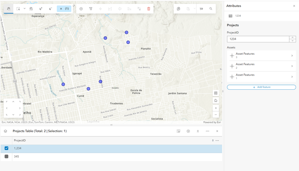

Now, one remaining challenge is that the Edit widget in Experience Builder only supports editing table records (the Project table layer) while in "Attribute only" mode. And "Attribute mode" does not support creating the related Asset features as you can do in the Map Viewer. There may be some enhancement request for Experience Builder here; perhaps a way to launch "Add feature" from within the Table widget when the Edit widget is present as you see it in Map Viewer.
One simple workaround for this "Attribute only" mode limitation, would be to use a Feature layer (e.g., polygon or point features) instead of a Table layer for Project records. Then the Edit widget can be used in "Interact with a Map widget" mode to edit both the project and asset features, and you'll be able to create related assets for every project.
Another option, if you still need to use a Table layer for projects, could be to use the Web Editor instead. There is also a Web Editor Instant Apps template (in beta, for now) that you can configure. Example below:
