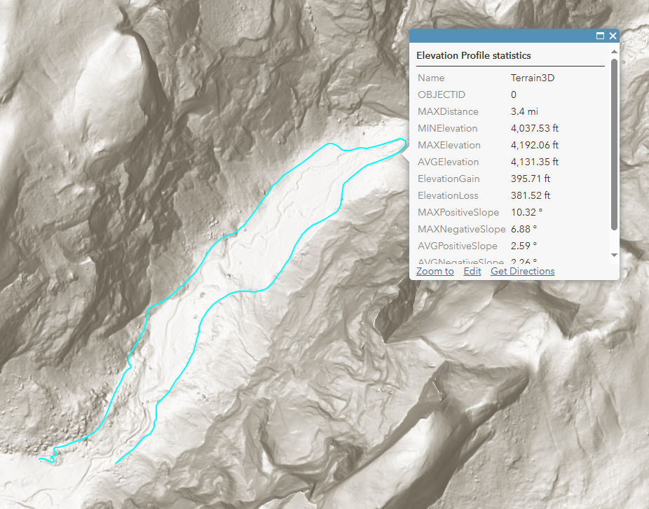

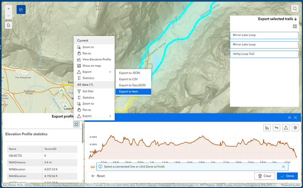

You can use Data action in other widgets to Export the selection or the Elevation Profile output to a new item in your organization or using another formats such as GeoJSON. You need to connect the other widget (e.g., Feature Info) to the statistics output generated by the Elevation Profile widget.
See sample: Elevation Profile Export
This exports the full line and the statistics.
Let me know if this helps with your workflow.

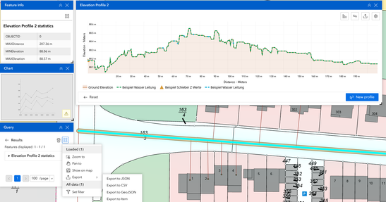

Thank you very much @AlixVezina for your quick answer. This was an option I hadn't explored. Unfortunately, it doesn't fulfill my request.

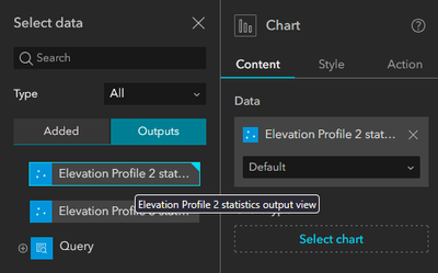

Although I can configure the widgets 'Feature Info' an 'Query' to display the elevation profile data as output, it only seems to display the general statistics of the profile, nothing alike the .csv export from the elevation profile itself, whose graphics I could replicate with this information. The exported item is a Feature Layer with spatial information, although it's just tabular information.
The other option is the 'Chart' widget, which should theoretically be able to reach the current elevation profile to construct a similar chart, but I couldn't manage to make it work (it looks like it can only reach the Statistics of the elevation profile).
