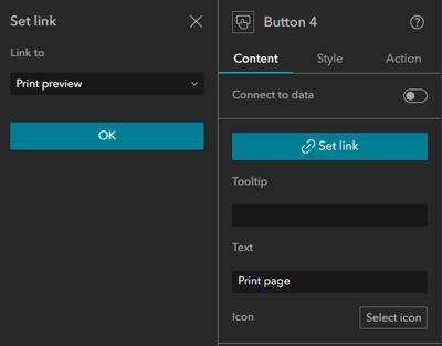

The Print widget is only meant for printing the map right now, there are no plans to include page content.
A workaround would be to Print the whole app page using the browser print You can use the Button widget and setup the Print preview link, which will trigger the browser's Print tool.
You can test it out in this app, there's a Print button in the top right. Underground Profile Viewer
Now, the browser Print functionality may have some limitations when printing the content within the browser screen. For example, before printing you'll want to check the printing settings and enable the Background graphics option.
This is not a perfect workaround. A simple screenshot could work too.
