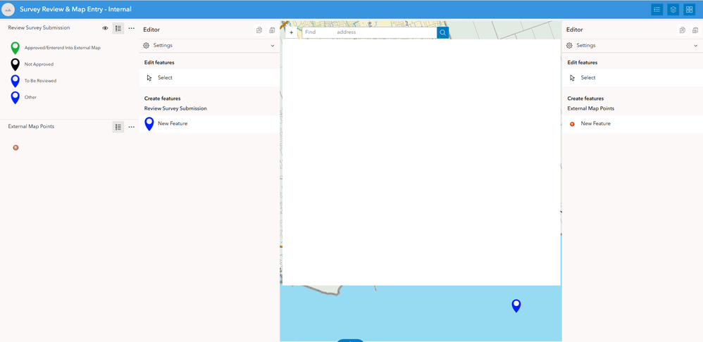

I would like to dock two Editor widgets as panes, one Editor widget as a right-side pane, and another as a left-side pane. Ideally, the panes would be collapsible.

You could probably set this up just by using columns in your project. Set one up on the left, one in the middle, and one on the right. Then add the edit widget directly to each of the sides (and not in a widget controller), and then put your map in the middle one. It's functionally like a docked pane, you just can't dock/undock at runtime (which I believe is true kinda no matter how you add them).
Bud
@ZachBodenner Yes, your column idea worked. Thanks.

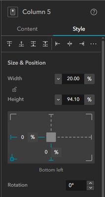

  1. Column: Layers/legend 20% width
  2. Column: Left editor widget 20% width
  3. Column: Map 40% width
  4. Column: Right editor widget 20% width
