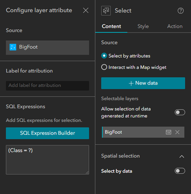

  1. In the Select Widget, use Select By Attributes. This will give you the ability to create the same SQL query you are using in the Filter Widget.JeffreyThompson2_0-1737666729173.png

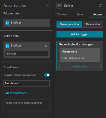

  2. If you want the data to also be filtered, use a Record Selection Changes > Framework > Filter Data Records Action, with your data being both the Action and Trigger Data.JeffreyThompson2_1-1737666887384.png

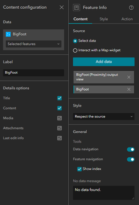

  3. In the Feature Info Widget, set the Data to the Selected Features View.JeffreyThompson2_2-1737666968788.png

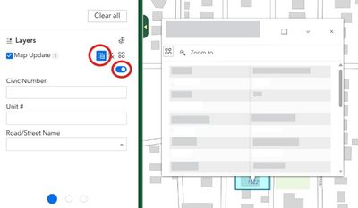

My only concern is if the end-user is not too map-savvy and wasn't sure what to click to get the widget to work and make their selection. It seems like I'll have to give more instructions on how to use the widget such as clicking the buttons or adding some images as a guideline in order to make the selection as seen in the screenshots:
If there was a way to make only one button like the "apply" button as seen in the filter widget it would be perfect. I wonder if anything more than this requires the developer edition to edit the selection widget.

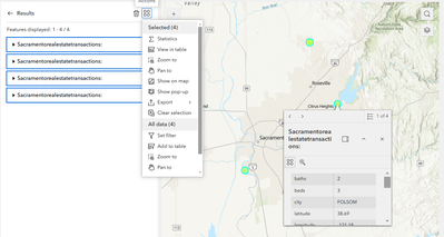

To hide layers and use the Query widget instead. In the ArcGIS Online version released at the end of February 2025, we will introduce the "select" data action. This allows user to select all query results at once.
When the "Show pop-up upon feature selection" option is enabled in the Map widget, the Popup will automatically appear upon selecting features.
