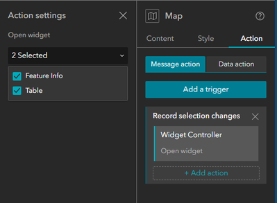

@ECJRIJS If I understand this correctly, I believe you should be able to do this today using message actions, for example:
Simply configure a message action to Open widget in the Widget Controller when a record is selected:

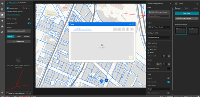

Thanks for the heads-up. I have tried this and although the table opens it does not auto-populate with data like you show in your GIF. Any idea if it is possible to auto-populate with whatever features are selected?

@ECJRIJS Yes, you can leverage the Selected features data view to show the selected features in the Table. Also, if you want the table to still display features when nothing is selected, enable the "View for empty selection" option in the data panel.
