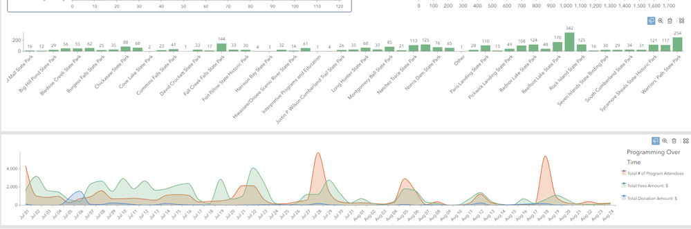

I was successfully able to add it to my experience builder this morning. The only thing I wish I had was the ability to use "objectID" as a sum field. In my case this is an experience builder "dashboard" visualizing Survey123 entries. I'd love to be able to show the total number of entries (or "features" in the dataset) overlaid on these other numerical fields which I can sum. Objectid is not one of the fields I can select. I am going to do a work around I think by creating a hidden field on the Survey123 form with a default value of "1" - so I can count/sum that field on this chart. Our project is having Park Rangers submit their education programs conducted through Survey123 - and we want to visualize correlations between donation changes and # of attendees for each program.
Thank you all for your input!
