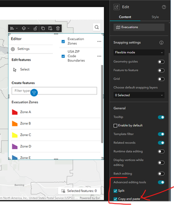

BrandonShiveley
@KatieQuantrell It was released last week. You can find it in the Edit widget settings at the very bottom under advanced editing tools. It is named Copy and Paste.

Hi all,
Copy and Paste in now available in Experience Builder in ArcGIS Online. It will also be available in Enterprise 12.1 which is targeted for May 2026. You can find it in the Edit widget, when using "Interact with a Map widget" Mode. The option is at the bottom of the Content panel, as part of the Advanced editing tools.
