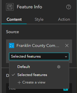

I'm working on an Experience Builder for my organization that includes a map and a Feature Info widget and Image widget to display information about features. The Feature Info widget is configured by the layer's pop-up in the web map.
Several of our users have called out the redundancy of the map pop-up with the Feature Info widget. It would be great if we could design the map pop-up separately from the Feature Info widget to avoid that redundancy. That way, at least for this use case, the map can be used as a sort of introduction to the information, with the Feature Info widget providing a more full summary of the data.

I agree @EmmaHatcher this is redundant and these two features (Feature info widget and popup) should not be linked or interchangeable. When I tried to edit my Feature Info Widget I thought I could get around the redundancy by "selecting features" I wanted to display in the Feature Info pane, but unfortunately no its still linked to the popup which makes no sense. What is the point of having a Feature Info widget if we cannot control what information is displayed in Experience Builder.
It would be really great ESRI if we could get a solution to this or at the very least have an option to unlink the Feature Info widget from the popup.
