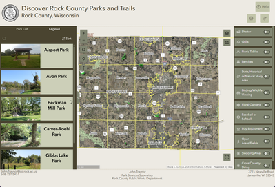

I have an Experience Builder App that has 18 filters, some of which are compound. The filters are all park amenities and the end user can toggle on one or more amenity to filter out which parks will meet their needs for their trip. I created the app anticipating that we would self-host the parks data. We have since determined that hosting the layer online would be a better fit. I am using the same map with the same data, just hosted in a different place. The only thing that is changing is the location of the data. When I change the source, every filter breaks and goes back to its default state. Meaning I lose the query, action, label name and icon. Not to mention all of the other functionality such as the list of parks.
I would like to be able to switch the data source in the map, or app without having to re-create all of the filters in the Experience Builder app.
