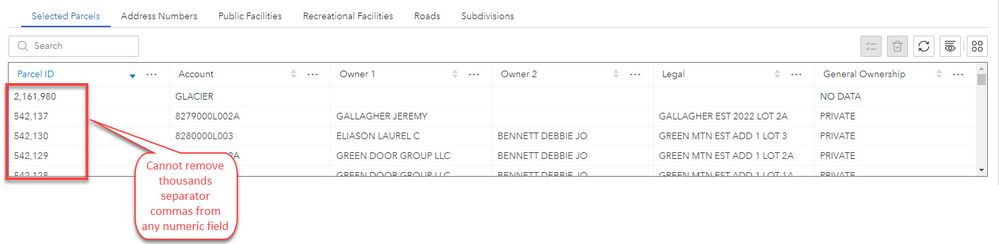

LaurenWinkler
There is no way to remove commas from a numeric field in the Table widget. Commas can be removed from the same fields in the List widget. Other users have discussed this issue at How to remove comma separator in Experience Builder table. Esri has a bug for this, BUG-000152331: The thousand separators are not honored by the Table.., but as of December 2022, it was not included in any release schedule.
