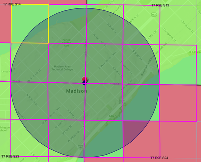

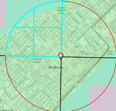

Hi @DavidEgginton  Is this what you're referring to?
Here's what my WAB Screening widget does - clips the polygons results to the search buffer:
Here's what Experience Builder Near Me widget does - no clipping of the selected polygons from search radius:
I'm just trying to see if that's what your idea is for. If not, I'm going to post one.
Thanks!

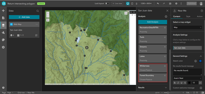

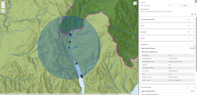

Hi @DavidEgginton,
I created an app to reproduce your workflow, I have 6 layers in the map, among them 2 of them are polygon layers (forest boundary and Wilderness)and I set them up to return only the intersected polygons. Try this app out and see if this works for you.
https://experience.arcgis.com/experience/1924340f7fa749048af756160007cb50/?draft=true.
I set the polygon layers to return closest feature and other layers are configured to return features with the proximity.

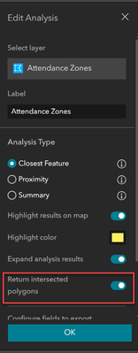

Hi @DavidEgginton,
We added this parameter in Near Me, Check your app after next week's ArcGIS Online update, you should see this parameter for polygon features in Closest and Proximity analysis. Please let us know if you see any issue while working with this parameter.
DavidEgginton
Thank you @AzizaParveen1, I can confirm this is working as expected. Thanks again!
