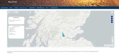

There's another option, something else I'm doing within ExpB. Instead of just inserting a map into the experience, I'm building experiences to support the look and feel I want in a map - using this approach and embedding the "map" does allow me to set a refresh rate against the widget.
The screenshot below is that map experience embedded, allows me a bit more design on the look and feel, along with functionality within the map. I've a refresh set on the embed widget.
