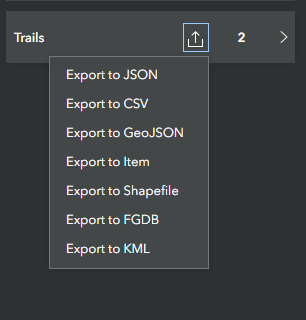

  • The new login widget - will this prevent errors displaying if someone signs into the app and there are layers they don't have access to? We'd like to build an app that multiple users have access to but only certain layers show in the map for the user depending on the groups they're in. This is possible now but the user gets error warnings and we'd like to turn those off if possible for a cleaner user experience.
  • For clipped features in the near me tool, can you get area measurements for the clipped polygons in the generated list? And can you export the clipped features to another format like KML or shapefile?
Thanks
Anthony
AzizaParveen1
@AnthonyJonesRSK
For clipped features in the near me tool, you will get area/length measurements for the clipped polygons/lines in the result list and you should be able to export to shapefile or KML at the layer level. Export to shapefile or KML is not supported at the batch export level when multiple layers are involved.
AnthonyJonesRSK
@AzizaParveen1, thank you for the clarification. That's great to know and will certainly be useful for some of our workflows.

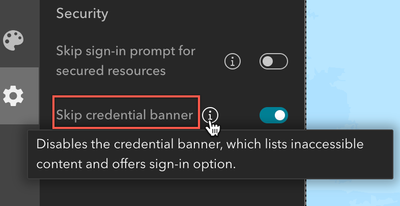

Jianxia
@AnthonyJonesRSK, have you tried enabling the highlighted option to skip the warning when end users do not have credentials to access secured layers?
JeffreyThompson2
MVP Frequent Contributor
@Jianxia I probably should have brought this up earlier, but one or both of these options is broken. They worked fine on Developer Edition, but on the deployed application, they completely blocked access to secured layers for all users. I wasn't able to do a lot of testing on this problem since it was effecting the live application.
Jianxia
@JeffreyThompson2, Thank you for letting us know. We will try to reproduce it in a deployed app from the developer edition. cc to @Wei_Ying.

AnthonyJonesRSK
Hi @Jianxia,  thank you for your response. I had no idea that was an option and so we've enabled it in one of our applications and it does exactly what we need. We hope to utilise this further in other applications where we may need to manage what layers users can see. Thanks for your help.

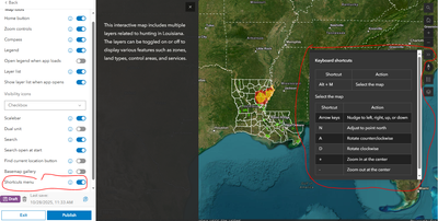

NikolasHolt
This sounds great, thank you! Could EXB please add "shortcuts menu" tool as well? I know the keyboard still functions for map navigation, but only in instant app is there a tool you can turn on where there are instructions. This will help comply with WCAG
Jianxia
@NikolasHolt, thanks for letting us know. Cc to @TonghuiMing

NikolasHolt
Hi @Jianxia @TonghuiMing any update on my below request? I'm not seeing it on EXB as a tool since the update. Below is a picture of tool as seen on instant apps
