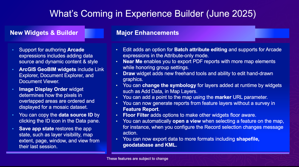

A preview of the new features in Experience Builder for the June release of ArcGIS Online, which is scheduled to be available in late June 2025.
We'd like to highlight support for authoring Arcade expressions. In addition, the Emergency Response Guide web tool is now available, which substitutes the Emergency Response Guide widget from Web AppBuilder.

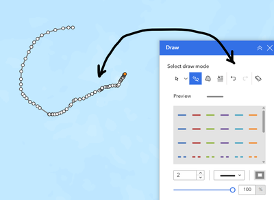

@Jianxia thanks for adding the draw widget with freehand etc in EB, it appears that the undo / redo buttons do not work. They are highlighted when drawing but disabled when mouse up finished drawing.
Snip of whilst drawing undo is visible:
Snip of when drawing finished undo disabled:

@PaulStanway2 The undo/redo buttons work only while drawing the graphics, not after they have been drawn. These buttons are useful for the polyline/polygon tools when you would like the previous vertices to be modified, but not so much for the freehand tools, just like you mentioned that you will never have a chance to click on these tools before mouse up.
We'll see if we can further enhance the workflow. Thank you!
