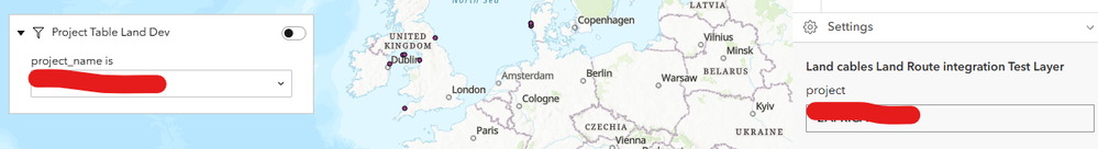

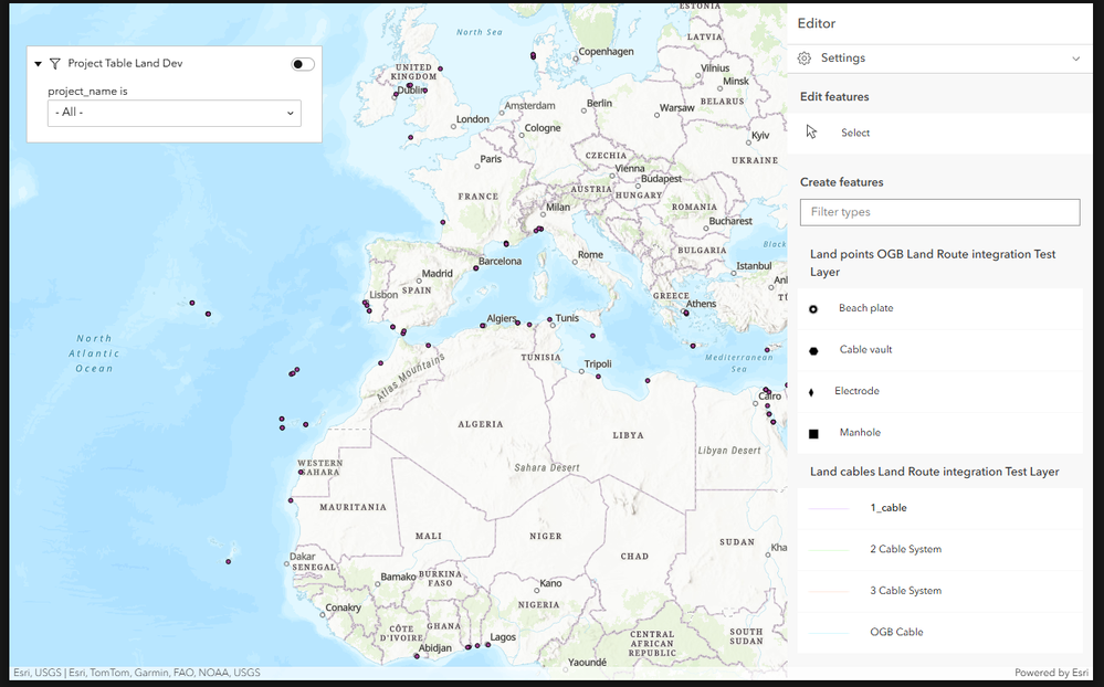

I have followed the steps above and I can replicate your results in Map Viewer. However when I try to replicate the result in an Experience Builder application using the Filter and Widget tools I have no luck!
The target field in the editable layer ignores the value in the filter widget and will only return the first value from the filtered layer. It seems that the edit widget is not "seeing" the filtered layer properly.
My target layer is a hosted feature service and my filtered layer is a hosted table.
I can see in the screenshot that the filter is toggled off but I promise that I tested it with the filter on....
Value in the field of the edit feature not the same as the filter choiceValue in the field of the edit feature not the same as the filter choice

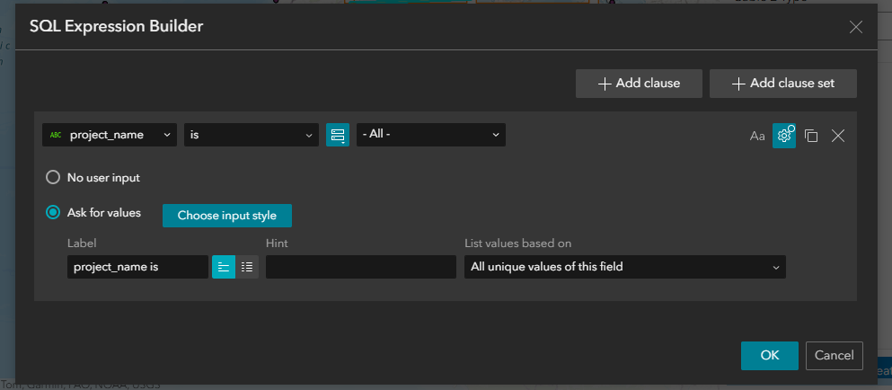

I would love some advice as this is exactly the functionality that I need!
