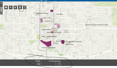

I am looking to create something like the summary widget in webapp builder. This at the bottom is dynamic. Is there a way to do this in EXB yet?

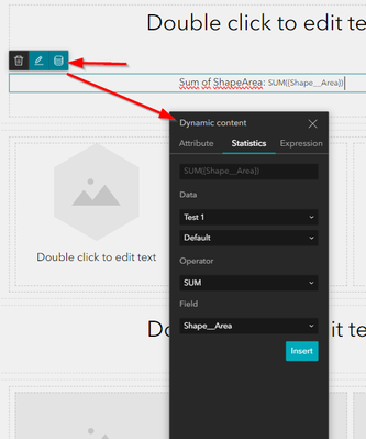

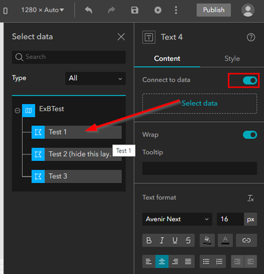

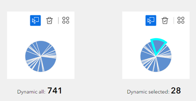

@Laura Text-Widget supports connection to data and dynamic content. Maybe you are looking for this - simple example:
  • add a Text-Widget
  • widget-configuation
    • enable "connect to data" in the widget-configuratio
    • select your desired data (and data-view)
  • on the experience-canvas, select the text-widget, dynamic content - define attributes, statistics, expresions to your liking which are then dynamic from you data/data-view (you can also use widget-outputs -> e.g. if you want the dynamic content listen to e.g. a selection of a chart-widget)

@AndreasEugster I like that a lot, thank you! How do I get it to change when I zoom in and out?
AlixVezina
@Laura You should be able to setup a Message Action in the Map widget to Filter the data based on the map Extent.
Laura
by MVP Regular Contributor
Thanks @AlixVezina I was looking within the text widget not the map. Seemed to do the trick.

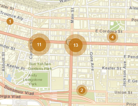

The WAB Summary Widget has the ability to group events on the map and display the number of events grouped at the approximate location. This is the benefit of the Summary Widget combined with its ability to filter events. The EXB Text Widget will provide the WAB Summary Widget's lower banner statistical summaries, but not the graphic summary of events. Please add this group display with the count functionality to Experience Builder. This is preventing us from moving apps from WAB to EXB.
AlixVezina
@LisaMacgregor
To recreate this functionality for Experience Builder, you'll want to setup clustering symbology on your layer in Map Viewer. See: Configure clustering (Map Viewer)—ArcGIS Online Help | Documentation

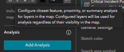

Tincan
Having one main icon per layer in Info Summary that also acted as a toggle for layer visibility is something I would like to have back. Fairly minor but I'd also like the option to not show the feature details in the widget and use it for selection and show the details in a popup only.
Most importantly I'd like to exclude a layer from analysis when it is turned off in the map. This is currently not possible.

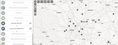

CTR_INTEL
Much like other people have said, the Info Summary Widget, although a basic widget, is very much a staple of the Web Apps that we have built.
I could even go to say it is one of the most important Widgets on our Apps as the data it showed and the way it interacted with the maps was perfect.
I've managed to recreate most of the stuff I need in Experience Builder in a more roundabout and clunky way.
However unfortunately even the workarounds provided above to recreate the info summary widget in Experience Builder just isn't hitting the mark.
The use of a symbol was quite an important feature, especially when you have a lot of feature layers, as it helps to quickly find a layer, so unless I've followed the steps wrong it is unfortunate that you cannot put a symbol on the overall layer like the below, only on the individual items in the layer when expanded. It's good that you can make it update the overall count based on the current map view, however it's a shame you cannot toggle the layers on the map like the Info Summary could do.
The only way I've been able to toggle layers on and off on the map is with the Map Layers widget, however this also does not have a symbol or the count of items.
Is there going to be any more development on this as we may have to look elsewhere for our mapping.
