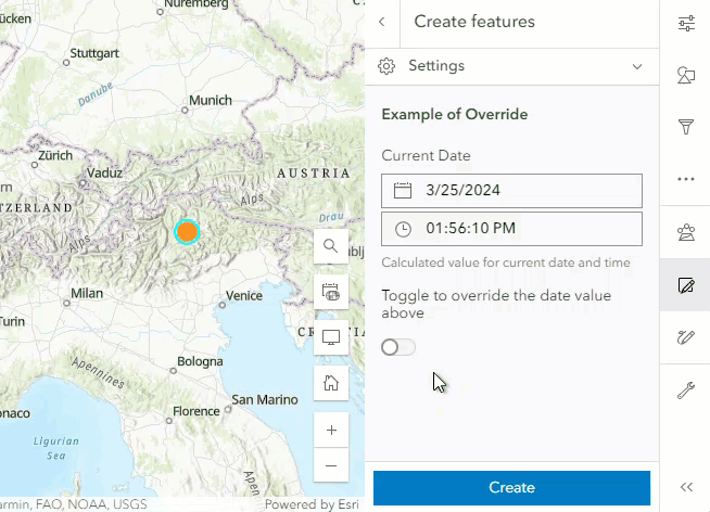

In the provided example, an editable feature layer has a Current Date field for which the value is automatically calculated based on the current date and time. Another field is used to define conditional editability for the Current Date field. If the Current Date field is editable, the date value can be changed. If the Current Date field is not editable, the date value is calculated and cannot be changed.

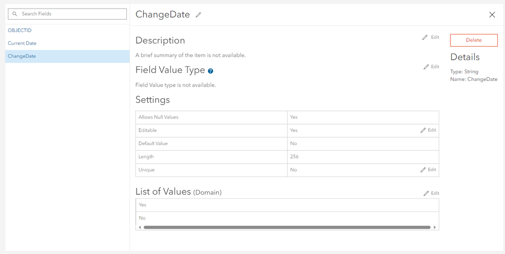

  1. For a new editable layer or an existing layer, add a new field of type String
    • Give the field a name (e.g. Change Date in the sample layer)
    • The field must be Editable
    • The default value for the field should be "No"
  2. Add a List of Values (domain) for the field.
    • Values should be "Yes" and "No"

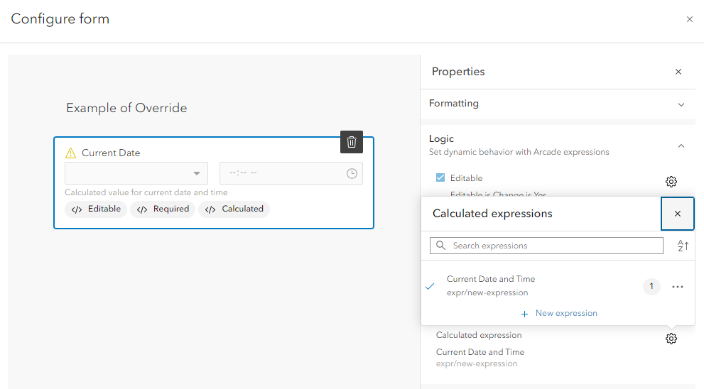

  3. Under Logic, define the Calculated expression using Arcade.
    In the example below, the expression Now() will automatically populate the current date and time into the Current Date field.

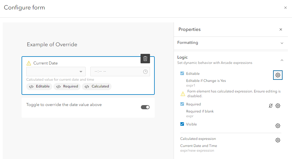

Step 4 - Add Logic for the calculated field
  1. For the calculated field (Current Date), under Logic, check the box for Editable and configure a new expression. (e.g. the Current Date field becomes editable if the Change Date field value is "Yes")
  2. Optionally, add an expression to make the field required if it's blank.
