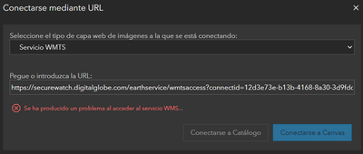

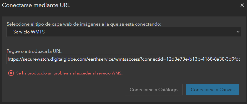

I am trying to connect to a Maxar WMTS, that needs user and password to connect.  However, I get an error while I tried to connect to Canvas. Does Esxcalibur only work with WMTS open (no needed user and password)?
The Excalibur version Im working with is 2.1.0
Thanks in advance for your comments,

Thank you for reaching out and providing us information. Currently, ArcGIS Excalibur supports non-secure WMS/WMTS layers from external sources so the behavior you are seeing is expected. We are investigating the support for secure WMS/WMTS layers in future releases.

Yes, I was able to connect the service using ArcGIS Pro without troubles.
I have tryied it using the structure you mentioned, but still the same 😞
Also, I have tried with a couple of WMTS that don't require user and password and they load perfect on Excalibur. Could it be that? the user and password needed to load the service? Maybe it is related with the structure but including the authentication credentials?
I have tryied the following structure including user and pass, unfortunatelly it didnt work
