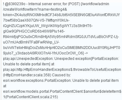

I've recently setup a Workflow server for an Enterprise setup, and we're not currently able to create or open any workflows, I get this error below:
Enterprise 11.1
A Workflow item is created, but as described below, it loads indefinitely:
When opening a Workflow item, it loads indefinitely, the server is working, ports 7443, 6443, and 13443 are opened and the services are running. The server is federated without issue on Portal and able to be changed within. I am also able to open the server manager and change any settings within.
Any ideas?

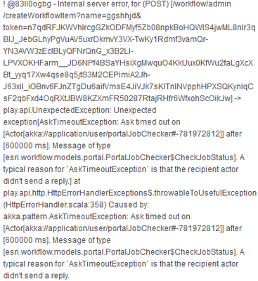

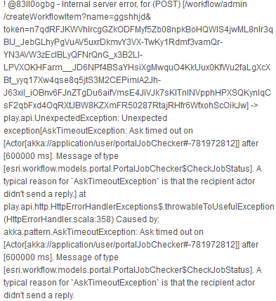

I'm getting these errors now:
After about an hour they came up, looks like every Workflow will take an hour to populate, still wanting that to be lower if possible.
I was able to access the workflow manager portal platform after accessing a feature layer created by the Workflow and placing a few points, then saving the map. I would very much prefer that we instead are able to use the manager without issue and without these extra steps.
