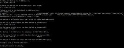

I've reached out to our director of IT and they are currently in the process of taking snapshots prior to the next upgrade attempt. I've also attempted to use the webgisdr tool to create a backup of our site, but something very unusual happens, whenever the backup is completed, it deletes the file with no warning. I've verified that it is accumulating data in the folder it should, and once the command prompt finishes, the file vanishes without a trace, do my output logs seem unusual? (Screenshot edited for internal security) There is 155TB able to be used in our backup server and the entire site is less than 2GB:
I'm not aware of the relational data store request, this machine has been restarted since last backup attempt.
Any thoughts?

You can try to save the backup on local disk, make sure you have the latest ArcGIS Enterprise Patches installed, if you still encounter an issue then open a ticket with Esri Technical Support to investigate further.

Thank you for the response Marcelo,
 I was not able to get it to work that way as well, looks like it's off to ESRI support, I appreciate the help!
