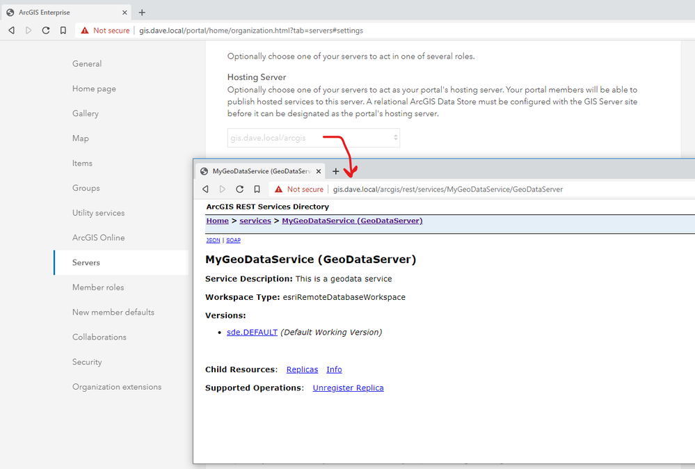

davehorsey1
Hi @John_S - I've just published a GeoData service to a federated hosting server without issue (10.8.1 single machine deployment)
John_S
Thank you for the confirmation!
