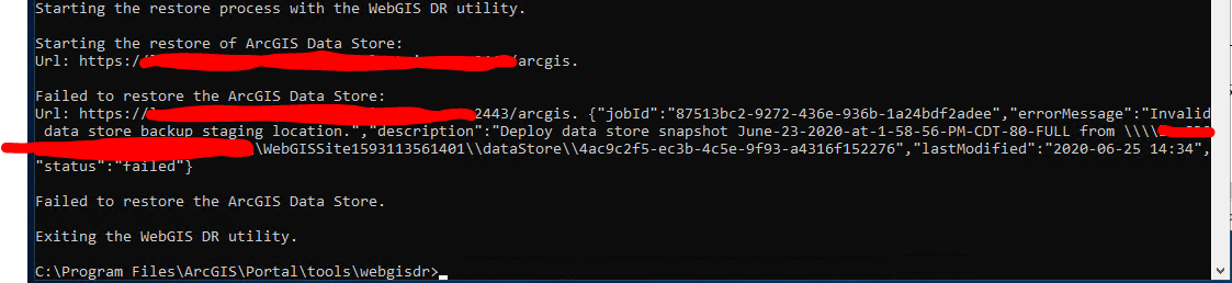

I have the new environment set up and installed, however when I try to run the backup import I receive the following error: snip
"Invalid data store backup staging location." Not sure where to go from here. I've contacted tech support but they're not seeming to find the issue either.
