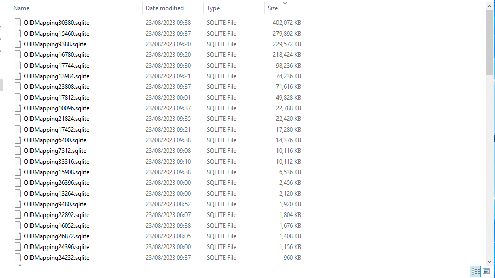

Have noticed in our Enterprise setup a large number of .sqlite files being created and causing downtime on our portal and apps. We have a script running to clear these down every night but some files being created during the day are over 8gb and a number of these cause issues before the script runs.
Is there a way to pinpoint the generation of these sqlite files and reduce their impact?

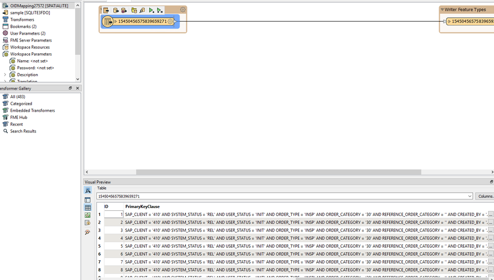

We have similar challenges with these large files that only seem to be created for a single feature class best we can tell by looking at a sample of the files containing objectid and what appear to be the definition for a sql where clause.
1. We're on Arcgis enterprise 10.9.1 and was unaware of these files with earlier versions although it may relate to something added since version upgrade
2. Files are C:\Users\{arcgis service account}\AppData\Local\Temp on each arcgis server operating system drive.
3. I can't share a file as the 'where clause' values are sensitive data. Screenshot shows snip with objectid and primarykeyclause columns and valuessqllite-sampledata.png

To close out my contribution here.  I raised a ticket with our Aussie distributer which became a formal BUG
BUG-000165475 has been addressed.
Description: Creating a query layer and publishing it as a map service to ArcGIS Portal will keep generating OIDMappingxxx.sqlite temp files upon usage, which will not be removed automatically and accumulate disk space.
ESRI Inc. advised Tuesday that the bug is fixed as follows "This issue is addressed in ArcGIS Enterprise 12.0 and ArcGIS Pro 3.6."
So until we move to ArcGIS Enterprise 12.0 or later, our temporary workaround of a batch script that runs at server startup to delete the files will continue.
We run the script at startup to ensure the files aren't locked or in use with any existing web service session.
Hope that helps to anyone reading.  Cheers from Australia
