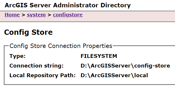

We are trying to execute the webgisdr utility on one of our ArcGIS Enterprise solutions. The ArcGIS Server 'Local Repository Path' is not the standard C:\arcgisserver\local\config-store but instead placed on a 😧 location. Here is a quick snip from the ArcGIS Server admin console:
And the failure we are getting from the webgisdr utility:

Foppe, Patrick‌ I can't reproduce the failure, but I can see that even though the local directory is set to D:\arcgisserver\local, the C:\arcgisserver\local\config-store path is created:
I'd reach out to support to get this logged, as more strict permission settings on the root C:\ drive would certainly cause this to fail, and I imagine, reproduce the error you're seeing.

This certainly seems to be a bug, but it's in the export operation within Server, not necessarily the DR tool. If you tried to export directly in the Server Admin API, I imagine you'd see the same error? I'll give this a try here and see what happens.

Thanks for the response.  You are spot on in that the Server Export operation is the ultimate culprit.  I was able to reproduce this on our production system and can confirm that the hard coded referenced C:\ path is not present.
