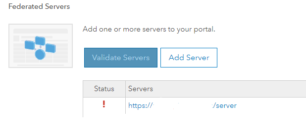

Federated Server Environment, Portal in S1, Server in S2, DataStore & EGDB in S3.
Initially Issue observed as ArcGIS Servies directory was disabled.
Enabled services from "/admin/system/handlers/rest/servicesdirectory"
Next Observed as ArcGIS Managed Database Validataion fails as shown below.
Recent Server Manager logs writes as below:
Severe : The connection property set was missing a required property or the property value was unrecognized. Instance not available on server DataValidator.GPServer
Tried to validate DS from arcgis/admin, got below message:
Failed to validate the data store machine 'XX.XX.XX.90'. 'Server machine 'https://XX.XX.XX.90:2443/arcgis/datastoreadmin/machines/XX.XX.XX.90/validate' returned an error. 'Invalid Token.''
Also observed as Federated Server Status also in red color warning, Unable to validate.
Restarted S3 machine, Portal service in S1 didn't solved the issue.
Any suggestions Please.
