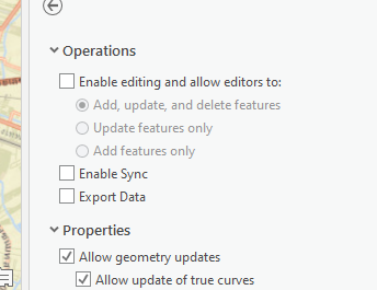

Hi @RyanDavis1 ,
So, disabling all editing capabilities from Configuration Tab in the Share as Web Layer tool will do the trick.
