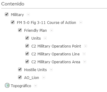

Sorry for the delay, but as far as I know the grouplayers are honored when sharing an mxd as a service. If you look at this REST end point: Military (MapServer)  you will see:
If you enter the REST end point (0) or (1) you will see that both are of type group layer:
If you add such a REST end point to a Web Map you can see that the group layers are honored:
