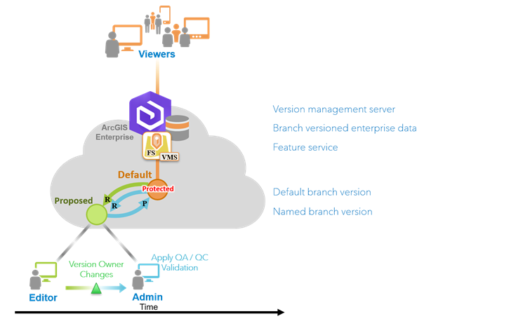

Because it's our system of record and as a government some legal stuff is based on the assets, we've chosen to use a protected Default branch, which makes it possible to do a QA before the edits a posted to default.
Branch version scenarios—ArcGIS Pro | Documentation

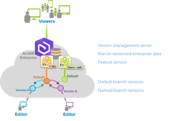

For our GIS viewers, we are implementing a separate service based on Default which can be used by anyone to just view the data, like this:
(the above image was modified by me from the source docs to include both the Query only FS and the protected default branch)

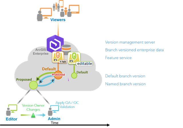

This would look like this:
