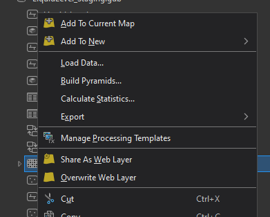

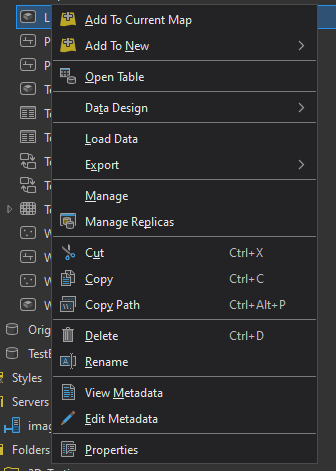

I am wondering how to share a scene layer to my image server from ArcGIS Pro. I would like to configure my tile cache data store with my image server instead of my hosting server but when I do this, I am unable to share scene services through the table of contents as this defaults all copied layers to the hosting server. This would be valuable so my hosting server does not need to handle this as well as the 2D layers we currently have running. I have been told that it is possible to share scene services through the catalog similar to raster datasets and the "Share As Web Layer" option but I am not seeing that when I select my 3DObject or Multipatch feature layers.
I am running ArcGIS Enterprise 11.1 and ArcGIS Pro 3.1.2
Raster Layer in catalog:
 3D Layer in Catalog:

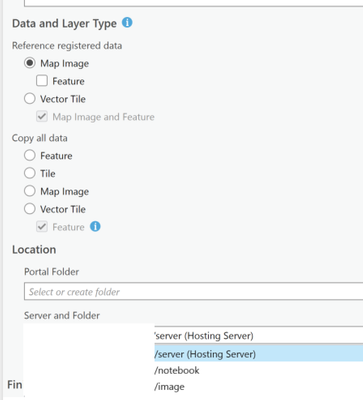

When adding a feature service to a map or scene, I can publish it to a server of my choice:

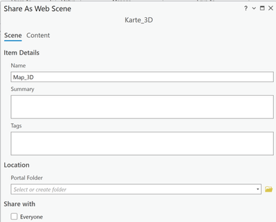

When I try to share a web scene, I don´t see any options to choose a server.
In the Portal Settings -> Servers I don´t see any settings that would allow to enable Web Scene hosting on the image server.

In your screenshot, you are referencing registered data which won't copy data to the server. If you select one of the "Copy all data" options, the ability to choose a server goes away. I am assuming that this means that you are unable to utilize a tile cache data store unless it is configured with the hosting site.
