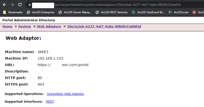

@wizgis log into Portal Administrator Directory and navigate to System > Web Adaptors > click on the Web Adaptor:

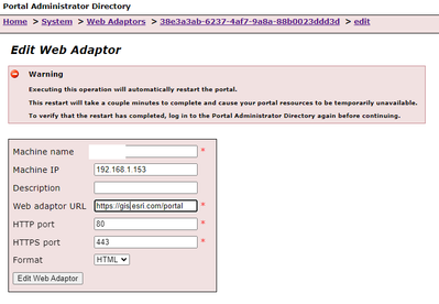

In the URL, add /edit.  Update the Web Adaptor URL to the external URL (i.e. gis.esri.com) and click Edit Web Adaptor:
Afterwards, try signing into Portal using this URL.  If this works, you should be able to restore the backup.

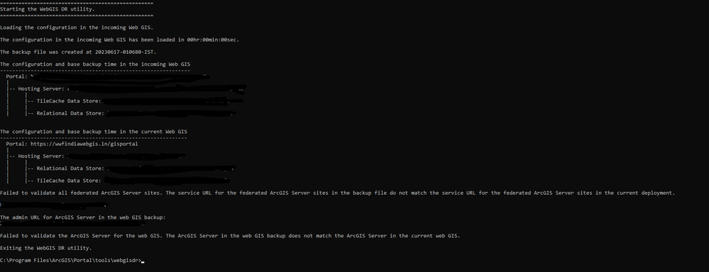

This suggestion helped me made some progress as I did not receive any error message related to publicportalURLs however, when I tried the restore process I now got the error of "Failed to validate all federated ArcGIS Server Sites."
Attaching the screenshot.
Any further suggestions.
JakeSkinner
Esri Esteemed Contributor
@wizgis check the Service URL (Portal > Organization > Settings > Servers) for the original and new environment.  Are these the same?  i.e. https://gis.esri.com/server
