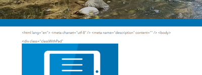

Yes everything is using https. I don't think that's related to the issue here. What I'm experiencing is a layout issue. I had a grid set up with different icons I created to link to different parts of the site, but now they don't line up the same way they used to, and some of the HTML is now just displaying as text, like this:

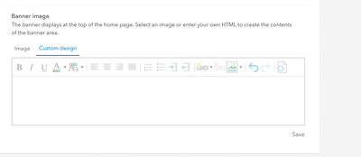

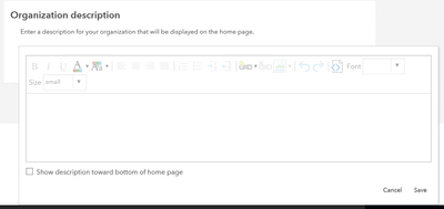

I don't know where you edited your home page either in the index.html directly or the Home Page Tab in portal, I know the location has changed of the index.html between 10.6.1 and 10.8.1 the current location is here, this file was probably changed during the upgrade and any JS does not get moves to the new location.
"C:\Program Files\ArcGIS\Portal\framework\webapps\arcgis#home\index.html"
If you edited the Home Page Tab then just try to re-apply the html the footer tick also gets turned of  during upgrade if I recall correctly.
Have a look at these two locations under the Home Page Tab
