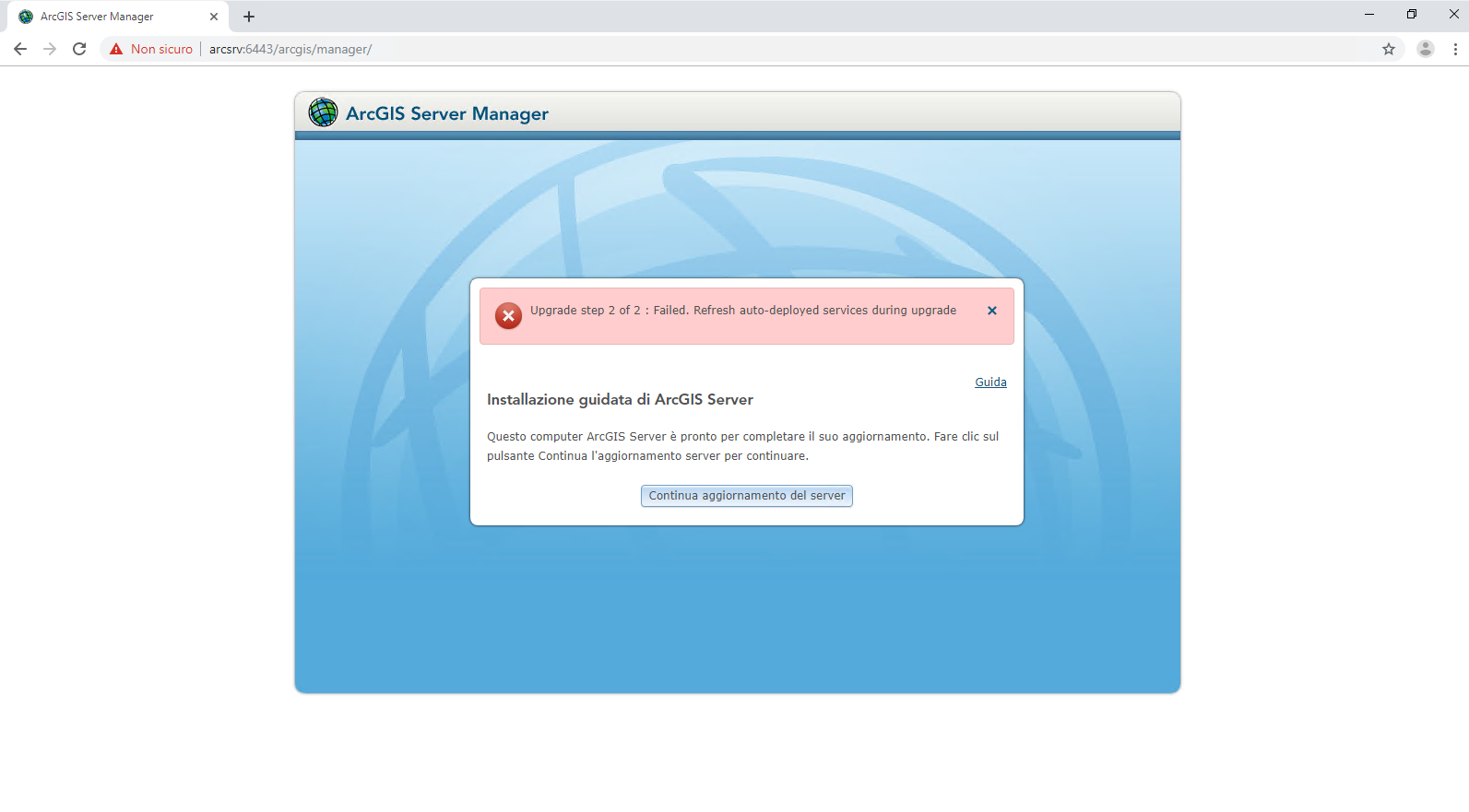

I have this problem upgrading from ArcGIS Server 10.5 to 10.7.1. I also saw other threads (1, 2) related to this but their solutions did not work in my case. Also, there's a patch to solve this problem for previous versions but not for 10.7.1.
I am on a Windows Server 2016 Standard OS.
After the AGS installation has completed, I need to click a button in the browser to continue the upgrade, but I receive the error Upgrade step 2 of 2 : Failed. Refresh auto-deployed services during upgrade.
I tried:
  • clearing the browser cache
  • running the browser as admin (both IE 11 and Chrome)
  • changing the URL to the manager (https://public_domain:6443/arcgs/manager; https://fqdn:6443/arcgis/manager; https://localhost:6443/arcgis/manager
No matter what, I still cannot proceed with the upgrade.
Any suggestions?
