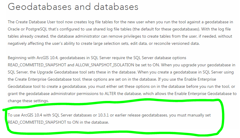

I have a quick question about upgrading a Sql Server SDE gdb to 10.4.1.  We plan on upgrading all our Desktop users and production Server to 10.4.1, and I'm wondering if it's necessary to upgrade our sde gdbs to 10.4.1 as well?  Our sde gdbs are currently at version 10.3.
I was reading through the What's New at 10.4.1 docs and came across this section on gdbs and databases.  We currently have users that are using Desktop 10.4.1 and our sde gdbs are still at 10.3.  I'm wondering what is recommended for our sde gdbs?  Should we upgrade them to 10.4.1 or manually enable READ_COMMITTED_SNAPSHOT?
Just wondering what the best practice would be?  Is there any 'downside' to not upgrading the gdb to 10.4.1?  Is it best practice to keep your client version and gdb versions the same?

I talked with customer support at Esri and they said keeping SDE at 10.3.x is fine, but recommended enabling READ_COMMITTED_SNAPSHOT on the Sql database.
FYI, our environment is Windows Server 2012 R2 OS and SQL Server 2014 Standard.  We haven't had any issues with people editing in 10.4.1 Desktop using a 10.3.x SDE gdb.
