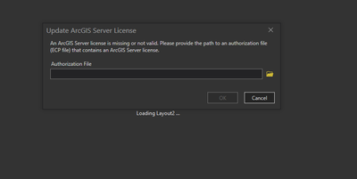

I am having issues with the server side. I can finally se my layers again in Portal and server manger, but the error in Pro will not go away

George_Thompson
Esri Notable Contributor
Have you tried to enter the keycodes file in that pop-up window?
