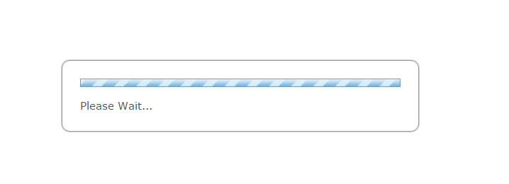

The server manager page keep loading all the time, I can't open it at all:)
