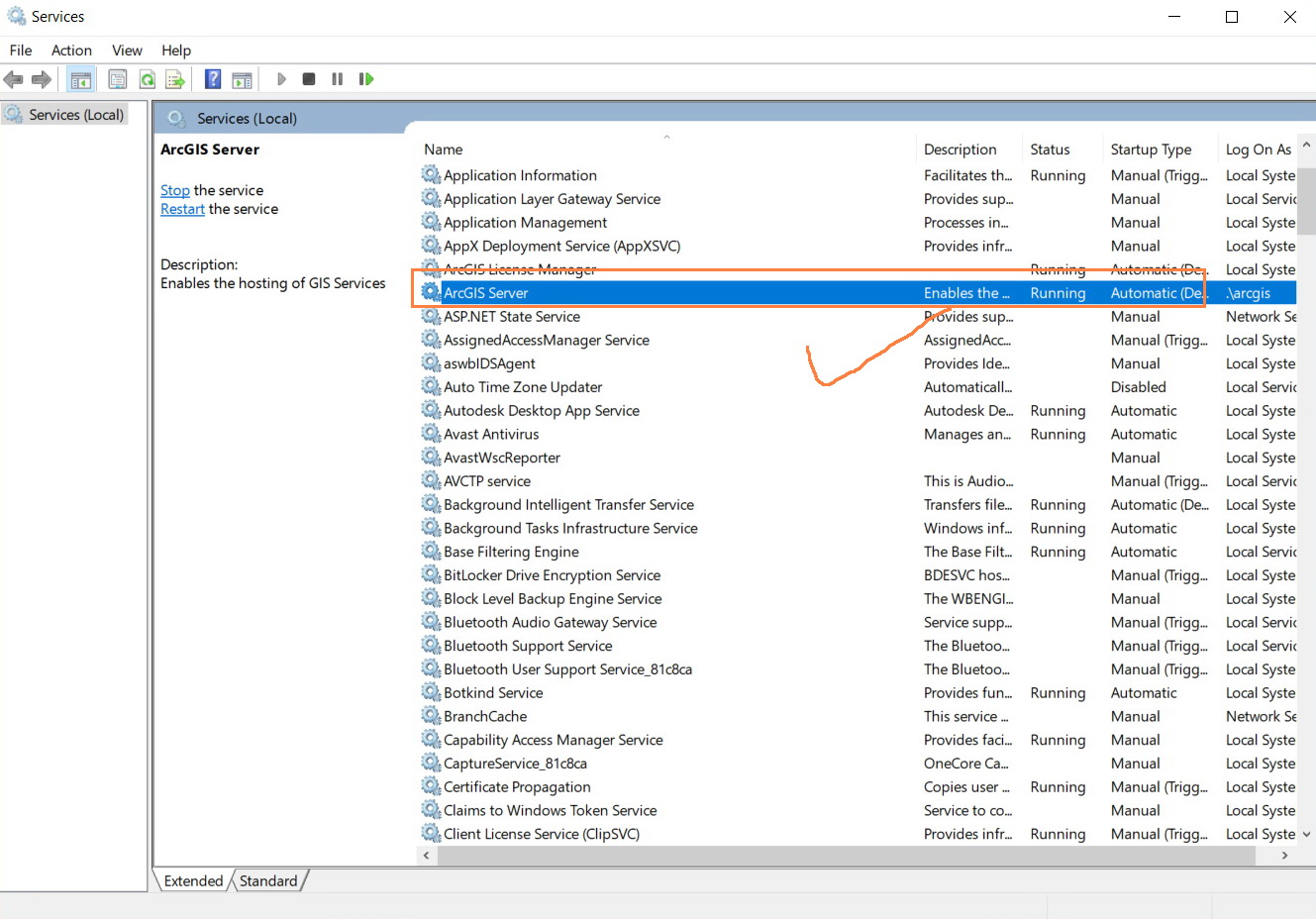

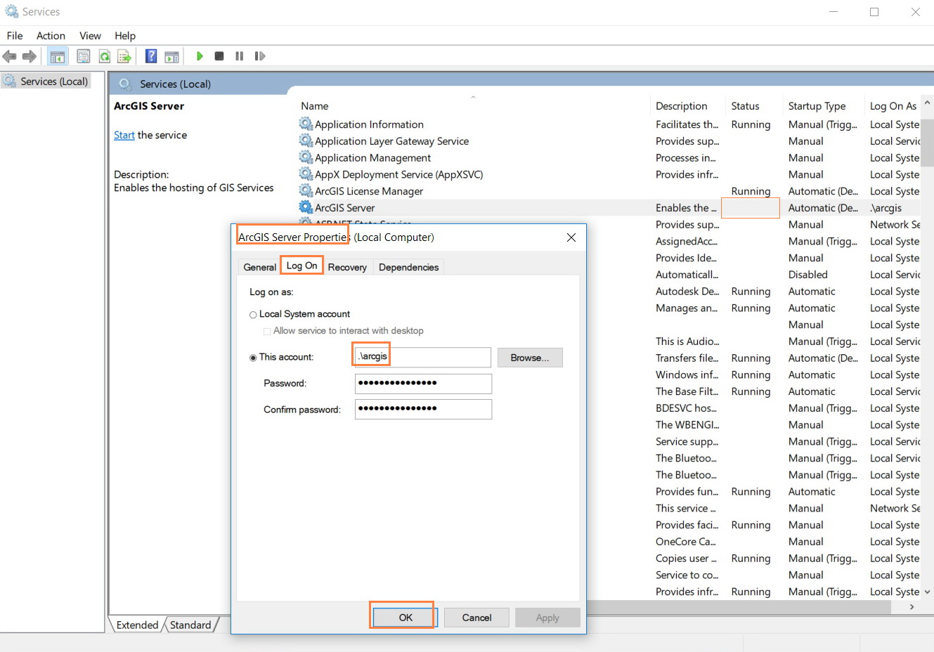

You need to make sure that the Arcgis server service is running, if not please try to start it. Otherwise, you need to go to the properties of the service change the user account to ./Arcgis and type its password. Kindly find the screenshots below:
