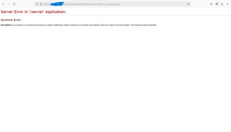

Our portal & server is publicly accessible. Recently, we observed that we are able to access portal publicly however, on trying to access server manager publicly we get the following error as shown in the screenshot.

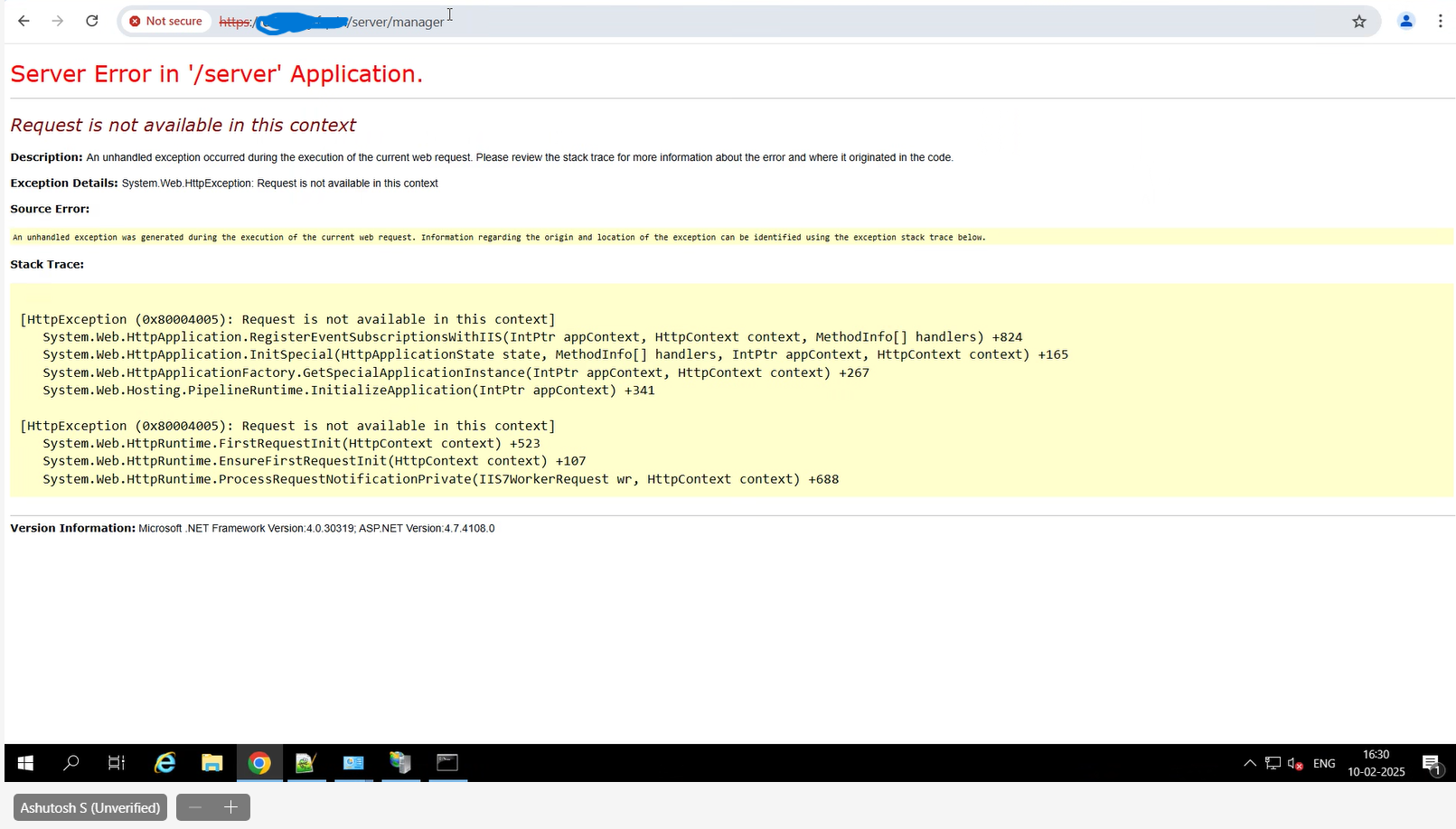

Further it was observed that when we try to access server & portal through the FQDN of the webserver machine on which WebAdaptors are installed, portal is opening successfully however, server is still not opening. Attached is the screenshot

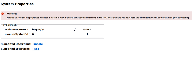

This is what I see here:
And is located here: https://<server FQDN>/server/admin/system/properties
You should be able to see the URL in the WebContextURL section.

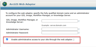

Hi @wizgis, when configuring the web adaptor, did you check the following option?
This will allow you to access ArcGIS Server Manager through the web adaptor.  If this is not checked, you can only access the web adaptor through https://<FQDN>:6443/arcgis/manager.  You can run the web adaptor again with this option checked to reconfigure.

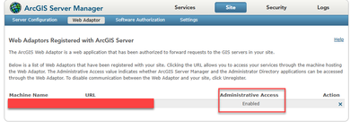

You won't be able to access Server Manager through the Web Adaptor URL if Administrative Access is not enabled.  You can check in Server Manager by going to Site > Web Adaptor:
