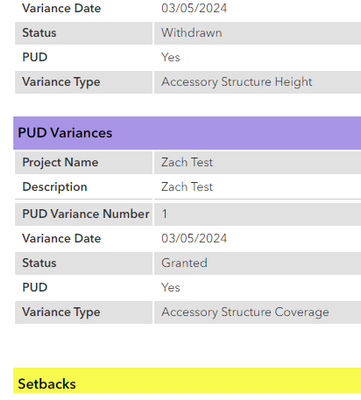

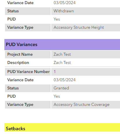

the goal is that after "var popupstring", if there are no matching filtered records, the resulting variable should just be empty. Here is what a parcel looks like if everything passes through the filters:

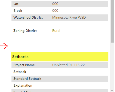

And here is what it looks like if nothing passes:
What I think should be happening is that I should still be getting the head variable showing up here, displaying "No PUD Variances".
