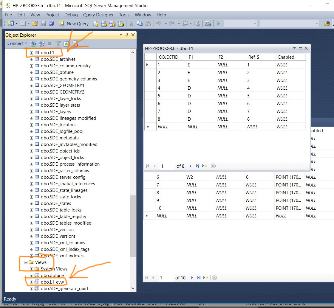

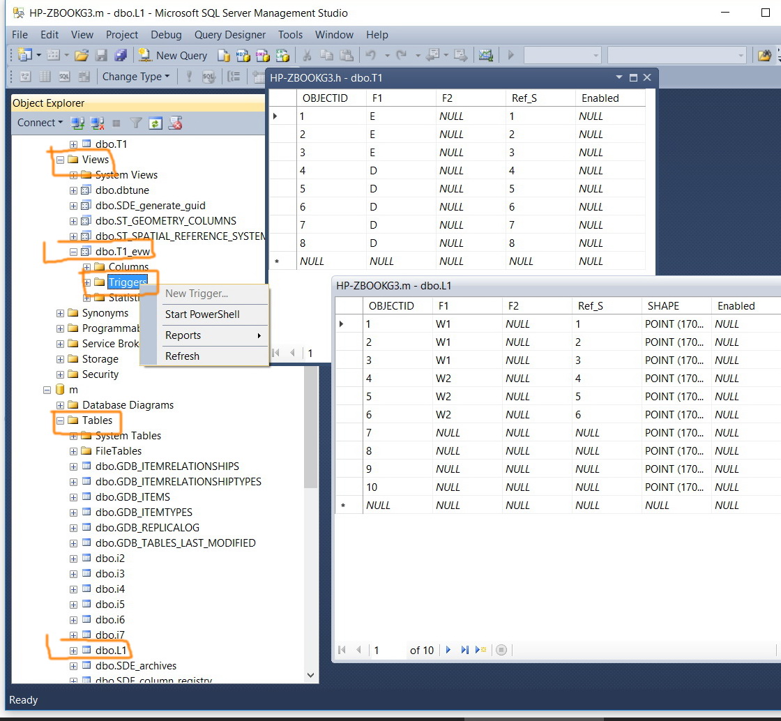

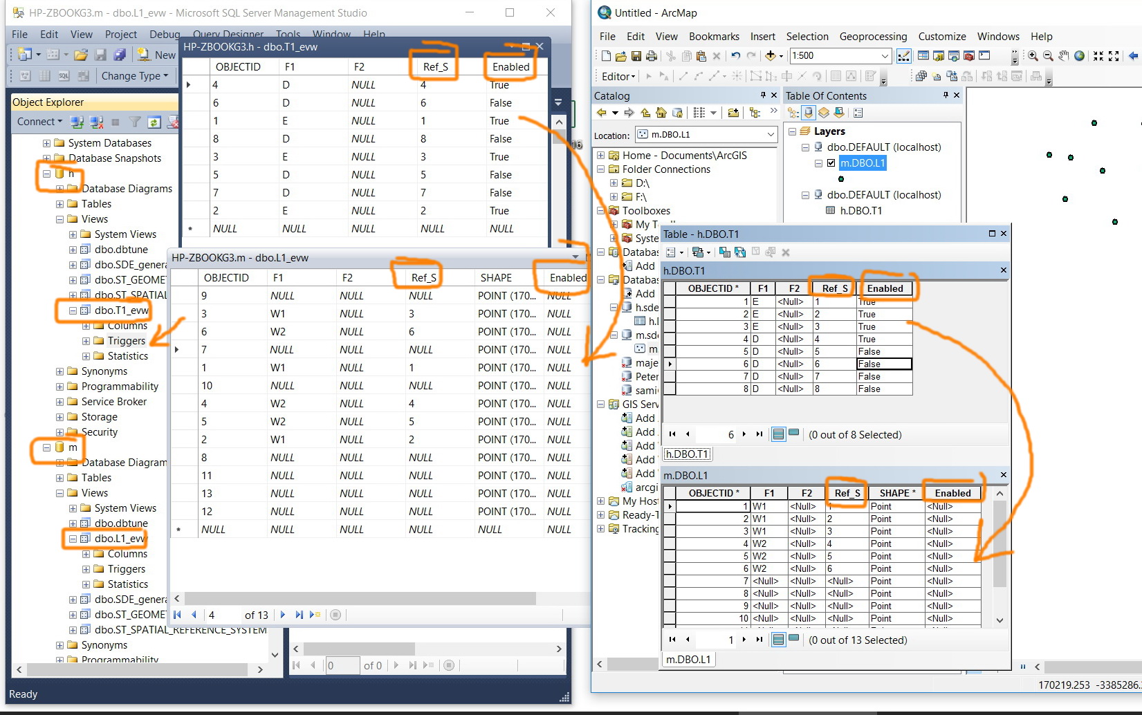

As per the screenshot below, I wanted to transfer the values of “enabled” field from T1 table (stored in h.mdf file) to “L1” Layer (stored in m.mdf file) based on the common filed “Ref_S” field. The idea behind is to write the values of T1 into L1 and thus the relation is supposed to be dynamic such that the changes in T1 will be transferred in the real time to L1 so that the values can be represented in terms of map. However, in this case, I’m not sure if the trigger will be directed to the L1 that is under “Table” folder or the one that is under “View”.
I would appreciate if anyone can help me out in writing the trigger.

Hi - Jamal, Could you expand a little bit on your feature classes? Are T1 and L1 both versioned feature classes? What type of versioning is being used? The evw views are system geneterated views that compile the base table with the delta tables based on a specific version. Default version is used by default, but using SQL other versions can be accessed. The purpose behind the evws is to be able to read or edit a FC using SQL, not ArcMap. So, there are a few variables to consider when you are trying to edit (or enable a trigger against) an evw. You need to know what version is being editied and the versioning methodology used (standard, move-to-base).

I wanted to apply this WITHOUT having “move edits to base” option checked. The target feature class is the one housed in the parent version.
In my workflow, I need the values that are stored on the table to be transferred to the attribute table of the layer. So, the update starts on the table and then the layer is updated accordingly.
