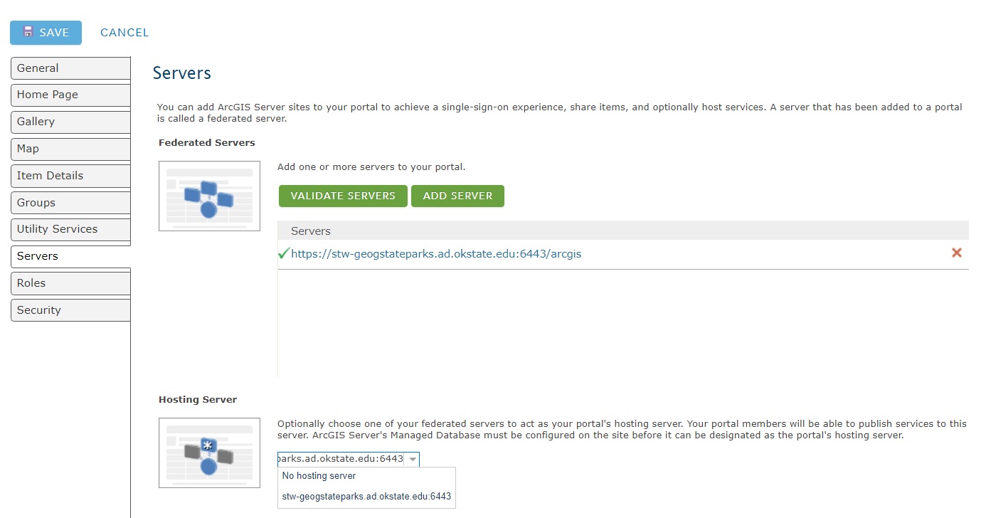

I really appreciate your time in advance. The token-based authentication failure was displayed from the Logs from the Esri Collector App when I tried to make the offline map. I feel this issue may come from the recently installation of federated server and hosting server with the Portal. Before the setup of the federated and hosting server in the Portal, the creation of offline map was working in the Collector.
The “0924TestCampsite” is from the REST service hosted on our own ArcGIS for Server (it is a versioned feature class with the GlobalID). In addition, I have tried to make the offline map in different places (different wifi). However, I get the same error listed below.

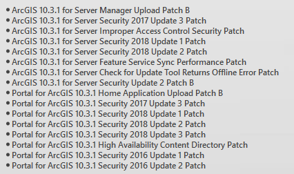

Patches installed in the server

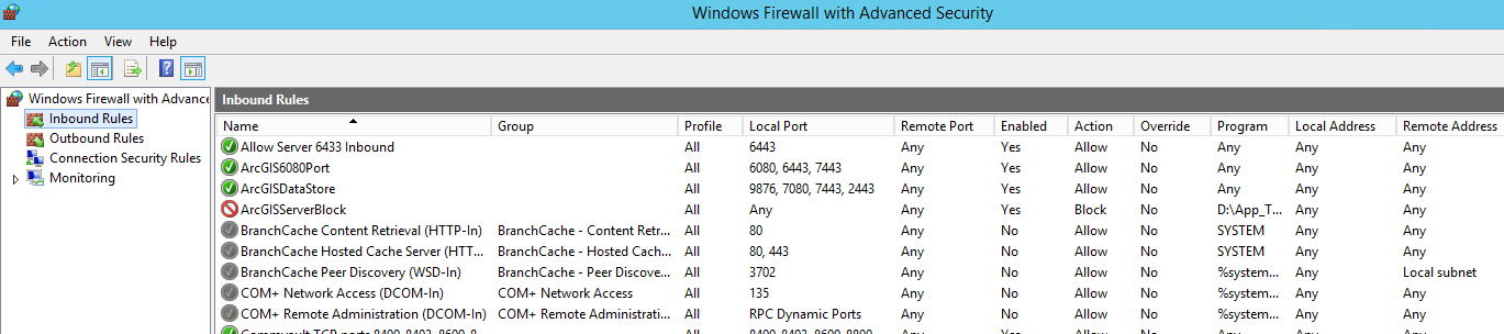

Inbound Rules within the firewall with the server
The inBound rules include the ports such as 7443 and 7080
