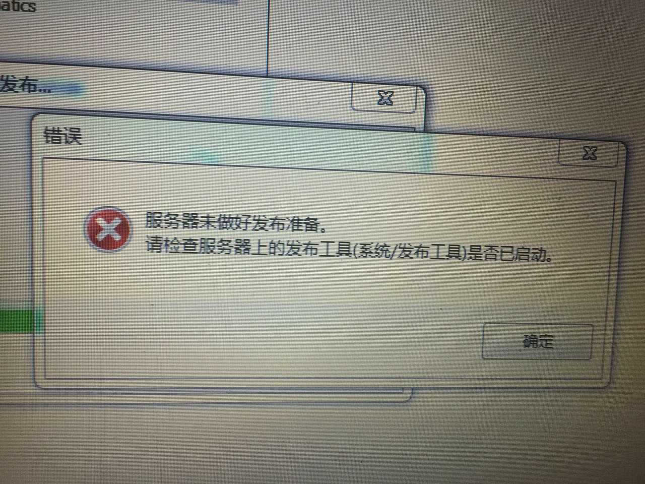

When I publish the webservice through Arc MAP 10.4.1 , the final stage of releasing service appeare 'the server is not ready for publishing.'
The sample service of Arc Server 10.4.1 can be access. Restarting the Arc Server service, it still doesn't work.
The Arc Server is authorized and was installed in the c drive of computer.
Does the Arc Server 10.4.1 need to reinstall or to patch???
