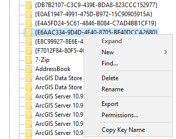

Hi @MarioBruschi,  I had the same problem the other day, but was jour data store working before the upgrade ? if yes,  then it is probably a broken registry key, you will have to go look for it in the register and delete it they are located here under regedit HKEY_LOCAL_MACHINE\SOFTWARE\Microsoft\Windows\CurrentVersion\Uninstall\
If you have a look at you add remove programs and it is not there but it is in the register then that is definitely the case.
NB please make backups right click and export they key before deleting anything
The key you are look for is {45E1C306-B1AB-4AE5-8435-818F0F9F8821} or ArcGIS datastore 10.8.1 just delete it as shown above.

thank you for your reply. Unfortunately this didn't work. The uninstall features are all visible in the apps and features apps. But I think we're on the right way. There must be a reg key that prevents the proper execution of the enterprise builder.
