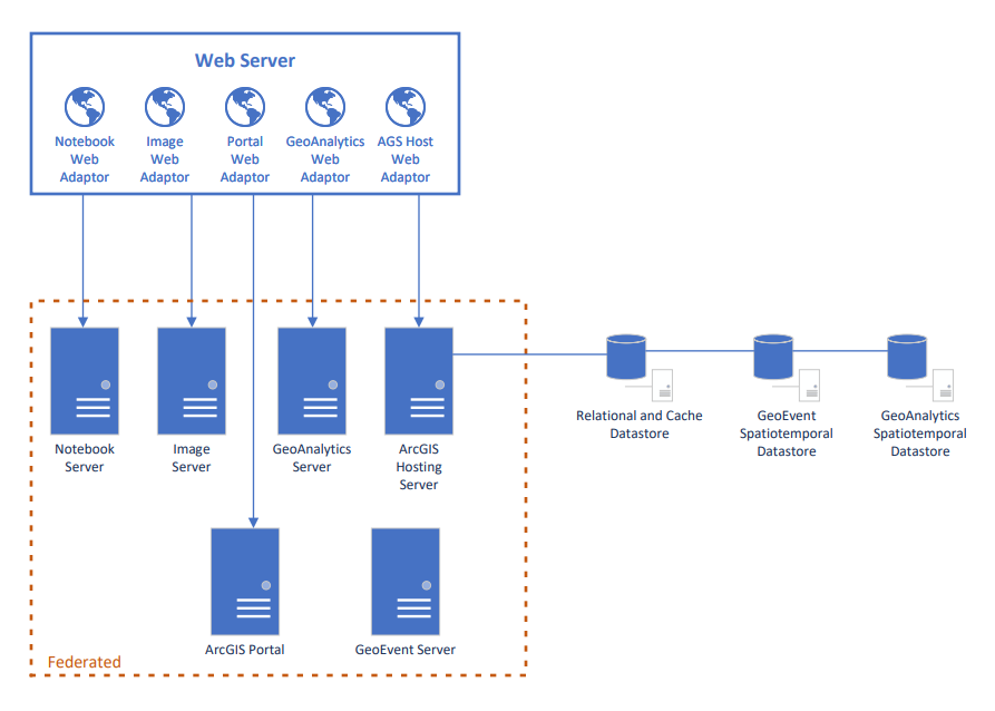

--------------------------------------Updated Diagram Below----------------------------------------------------------------------------
Does the datastore configuration make sense?

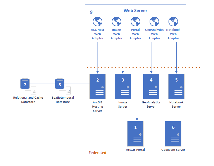

--------------Update #2 Below----------------------------------------------------------------------------
Seems like this configuration makes the most sense, right?
I am in favor of having a single web server for all of the web adaptors needed for a full AGE platform. It makes it convenient to have them all in one place, all the servers end up with the same base URL, and you can use a single SSL cert for all of them.
I don't know of any limit to the number of web adaptors you could install on a single web server. We have 5 on ours.
Good point about the ssl certs.
