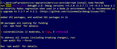

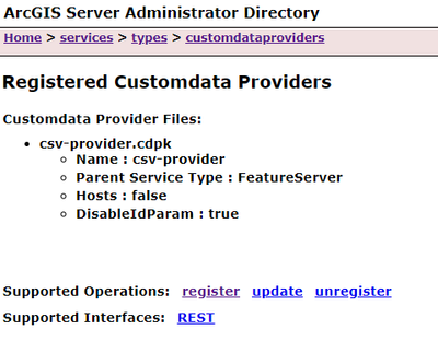

SimonGIS
Update: OK, I found out that I had to use version 2 of node-fetch:
npm install node-fetch@2
Thank you for this.  I was running through the steps in the CSV sample
And got the same Node could not start error.
Added node-fetch@2 to the provider and now it registers.
