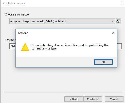

We recently setup ArcGIS Server 10.6 (on a Windows 2012 R2 VM). I am trying to publish a service from ArcMap 10.6, but receive the following message: "The selected target server is not licensed for publishing the current service type." This happens immediately upon selecting the connection in the Publish a Service dialog window. The best we can tell, the server is properly configured and licensed.

Ah, you need to also license that site for ArcGIS Enterprise Advanced license. That license is required on the machine for publishing.

This is normally seems to be related to licensing issues. Can you provide a screen shot of the following: Server Manager page > Site > Software Authorization

Thanks for your assistance. Our system administrator seems to think ArcMap is looking for server resources that are not installed on my local machine and that installing Portal on the server will fix this. Then again, there may be additional licensing issues. Here's the screenshot.

ToddFagin
That appears to have done the trick. Thanks again.
