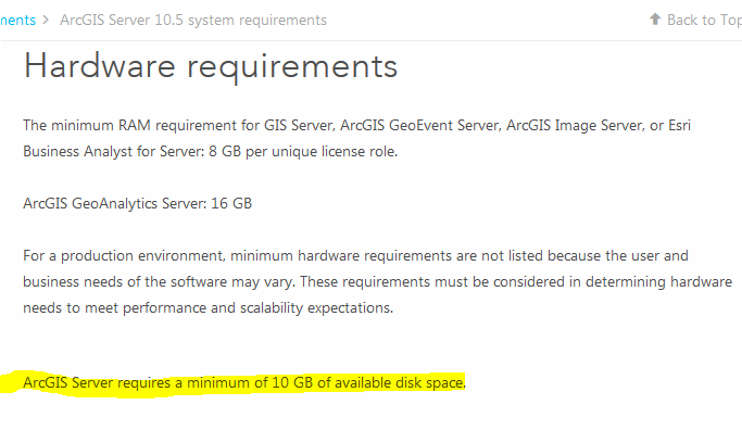

Which I couldn't find, but then noticed my C: drive was about full.  Cleaned up the install, moved the expanded install files from MyDocs to D drive and cleaned up.  My drive now says I have almost 5 GB.  Tried again...still short.  Finally went to the install help docs, and for 10.5, it doesn't state the requirements the way it used to, although it does show that the disk space required since 10.3.x is 5X more.

Does list "Disk Space requirements" the same way, instead lists it like this...

In an effort to close this thread, yes, the disk space requirements did increase, and the information is stated a bit different in the help doc.  To install, I did not need 10 GB as the help stated, but I did need over 5 GB available space.
