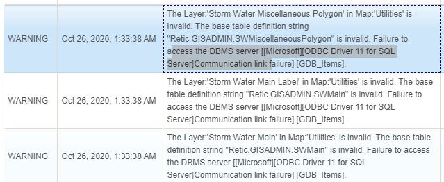

Hi,
I've recently installed ArcGIS Monitor 10.7.1 and I'm now receiving quite a few email alerts at times when we are:
1) Running the Webgisdr Tool (on Enterprise 10.7.1)
2) Performing Enterprise Geodatabase Maintenance (Compress, Rebuild Indexes, Analyze Datasets on SQL Server)
These above process are all scheduled to occur and night.
What I'm trying to avoid is ArcGIS Monitor sending me severe or critical warnings that are related to these backups, enterprise gdb maintenance while the alerts are valid they aren't required.
I thinking that these alerts are happening because we don't stop our map / feature services before performing the above processes?
Backups using the webgisdr tool start at 11pm, severe warming occurs at 11.02pm
Enterprise Geodatabase Maintenance begins at 1.00 am and I get alters from the services saying that they cant access the  DBMS server
What is the recommended procedure? Should we stop all of our services first ? what are other organizations doing ?
