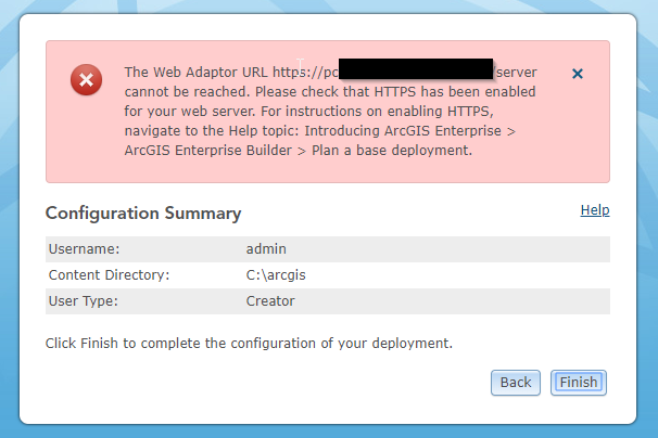

Hello All,
I have installed ArcGIS Enterprise 10.7.1 on my pc (windows) as a part of my developer subscription. I have used ArcGIS Enterprise Builder. All was great up until I step 5, Configuring Web Adaptors. It requires https, for which I need ssl certificate. First of all, I don't have one and I thought I can get away without it as everything is installed on my pc (single machine). As it is just for testing, I don't think our IT department with assist with the certificate.
Is there a way around it?
I found few articles from ESRI describing exactly my error,  'Create a domain certificate and enable HTTPS' from here Plan a base deployment. But it is just on my PC and I am not sure how to create certificate myself (if it is possible).

If it's just you using it, you'll get by with a self-signed certificate:
How to Create a Self Signed Certificate in IIS | About SSL
Once you do that, bind it to the 443 endpoint:
How to bind an SSL certificate in Microsoft IIS 7.0 or 7.5?
You can ignore setting the Host name property.

If you're using a self signed certificate, no browser is going to trust the certificate by default. You need to import the certificate into the trusted root authority store to force the OS to trust the certificate.
Yes, the idea is that the certificate will be created for the FQDN where the AEB is being installed on. The SSL certificate parameter is just the name of the certificate, it doesn't need to match the FQDN it's assigned to. It could be "myCert", doesn't matter.

Jonathan Quinn‌'s answer is correct. To elaborate slightly on his answer... you are using the default self-signed certificate that comes with the base installation. This certificate is only intended to be for testing that the deployment installed correctly, and can cause issues with accessing the Portal from client operations among other things. It should be replaced with the user's self-signed certificate, a domain certificate, or a CA-signed certificate. You can follow the steps Jonathan posted to generate your own self-signed certificate.
