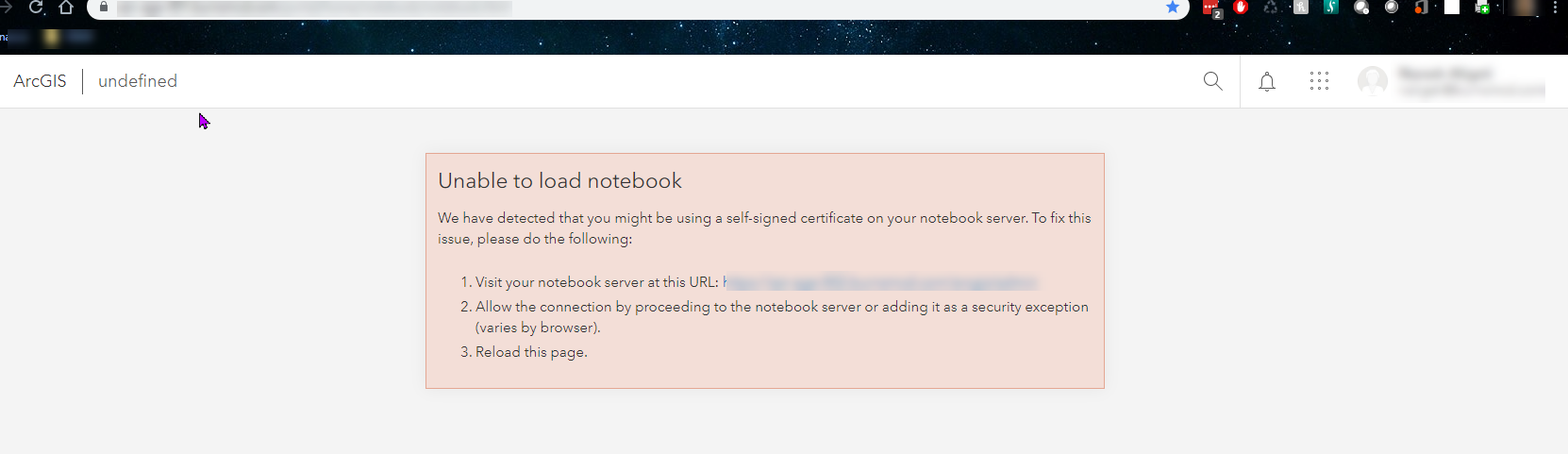

I've recently installed ArcGIS Enterprise base deployement on server 1 and installed a Notebook server role on server 2. All documented steps performed, everything good to go, except, Notebooks won't open and I get this message almost every time I access notebook.
After great deal of further drilling by me and Esri support, we found out that Docker Desktop which was installed as a prerequisite for ArcGIS Notebook server stops when a user signs out of the machine where docker is installed. To test this, I logged on to the notebook server and then disconnected (not signed out) then tested the notebook url, it works like a charm.

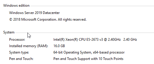

Server specs:

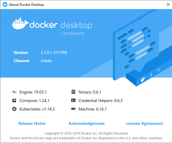

Docker Specs:
